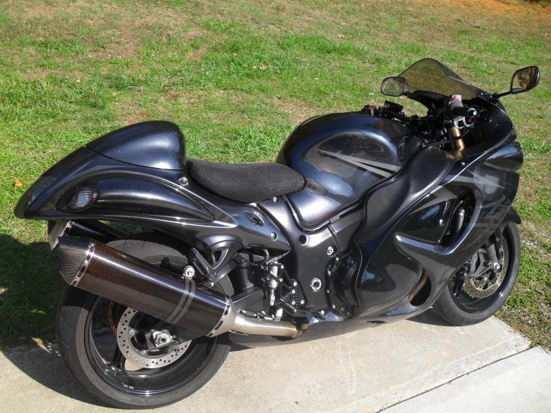

i have 4-2-1 Tiforce exhaust pipes and pippercross air filter...thats it.
Now, the low and midrange power is weak...high range from 120mph till 200mph it goes very fast...
What can i do to improve my low and mid range?

Ti-Force makes a a full single and a full dual exhaust also, and with carbon fiber, ss, or titanium mufflers.
They are out of business and used are hard to come by.
But high quality and big gains for just an exhaust.
A deep tone unique to the brand.
Always something to get if you run across one, as you'll have no problem selling it if you don't like it for any reason.
If you can find a Sumo it's the best of them from Tiforce
