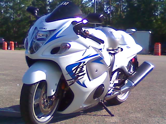

I like the way your bike looks. Have you thought about a blank kanji and some black gsxr stickers for the tail ?
thanks and yea, im getting a new set of plastics to have repainted here pretty quick. i may graphic these up as the only thing that will be re-used is the tank and the hump. im debating whether to go crazy and get it all air brushed out. dunno really what im gonna do yet.
the reason im getting another set a hack painted these up and layered it on thick in some areas. incomplete coverage in others. some of the pieces werent completely disassembled when he painted it and its cracking there. wrinkles etc. it looks ok from a dist, at night, or at a glance. you get close and start really looking at it and it looks poor.
