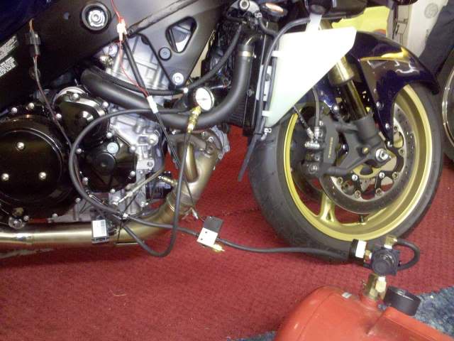

Here is boost pressure vs rpm from the pulls we made :thumb:
Got a chance to do some testing this evening with petriks ECU boost control :)
I had a choice to either drag the bike out to the barn where my tools and air compressor are, or rig up an air tank with a regulator on it to be the supply source. I basically have an air supply feeding a 1/8 npt air solenoid that is controlled by your software petrik, then on the output of the solenoid i am feeding the top side of the wastegate, gm 3 bar map sensor, and a mechanical boost gauge for me to watch. Engine is off, and just monitoring boost pressure on the top of the gate. I have a small air leak somewhere, but a leak of some sort is needed so that the wastegate can relieve itself, i think with the adjustable exhaust leak i have on the solenoid you can tune how quickly the boost bleeds back off when you downshift to a lower gear, making it leak off quicker will make the solenoid have to run more continous to maintain pressure.
Anyhow here are 2 videos, 1st with lower pressure, 2nd with higher pressures, there is some overshoot, but its hard to say how actual behavior on the road would be as I would be just using the manifold for air source vs 30 psi coming from an air tank, it would have longer to build up and probably overshoot less.
Anyhow, man for a first crack this seems to work pretty darn good!

Even with stock arm 3 psi and low compression is pretty lame, gotta get playing with ecu controlled gear based boost control.
