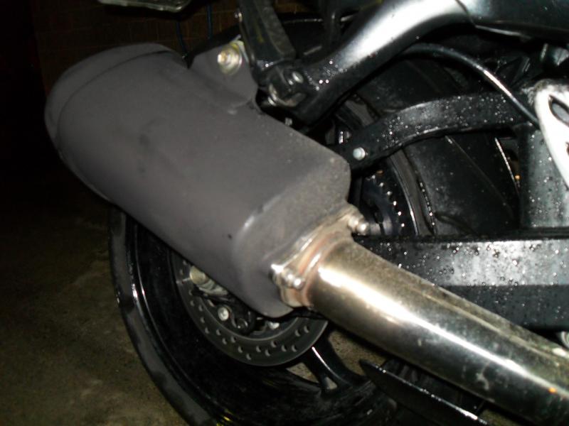

I recently cut mine, but went an easier route. The rivets, threaded rods, and drilling holes is all good, but alot of extra work. I measured and cut mine in half(11" gone), 1 cut per muffler with a reciprocating saw. Looking into the open cut end of the muffler it's about 2 1/2" deep, then a solid wall making the first (and now only) chamber. It has about a 1 1/2" diameter pipe exiting the bottm of it, this pipe is flush with the open cut end. If you look into the now replaced end cap, you can see the top of it, but because everythings black now, it's hardly noticeable.
I grinded the spot welds off the end cap screws and removed them. My friend welded the chrome caps back onto the open cut ends. One short bead on the inside of the cap, and a couple of tacks where they aren't really visible. He also filled and smoothed where the screws holes in the caps were. Then sprayed the whole mufflers, chrome cap too, with hi temp flat black. The mufflers are now 1 chamber instead of three and have a nice sound. They are not excessive, just a smooth tone.
I also removed the front chrome covers from the midpipes and cut off the brackets for them. My convertor was gutted a while back too, making a barely noticeable change in sound. The leftover scrap from the mufflers weighed 11.5 lbs on the scale.
If you or a friend can weld, this is quick and easy sound with a little weight loss, and I(we in this thread) think it looks alot better. Thanks everyone for a great idea!

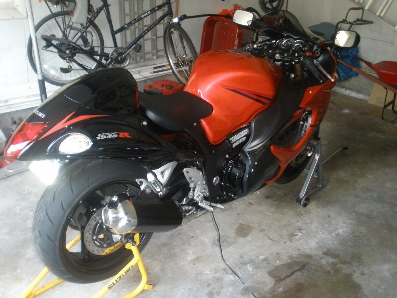

Mine are the same size and look like yours aside from color. Yours look good with the chrome on that orange:thumbsup:

If you have a reciprocating saw and a welder, or know someone who does, it's a quick simple job. 1 saw cut per muffler, and a few small welds. We'de do it for free, but we're too far away. A local weld/fab shop should be able to do it very cheap. The cut in the muffler is 4" behind the hanger bracket, or really where ever you like the look of it. The welds are on the inside where they are least visible, or again, where ever you want them.
There are gaps around the end cap on everyones too, since the muffler tapers smaller as it gets closer to the midpipe.

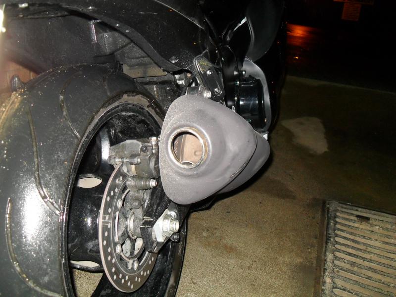

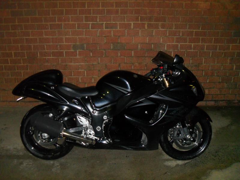

It's still raining, but here's a few pics of how they turned out. The paint is good too, it's just road grime from the rain.
sixpack577 the second last pic that peice you can see inside of your muffler is gone on mine.. im worried if i cut down my pipes it will be like there's no mufflers at all..
If you mean that whole wall, yeah, it'll be louder. But I didn't re-use the end of the pipe either, just the end cap itself. If you have the end welded on, it'll be alot quieter.
One of the posts here shows the end cut off, and the center of it pushed out(the part with the 3 prongs with the threaded holes for the end cap screws)
I just held those ends over my cut pipes before any thing was welded, and it sounded stock.
