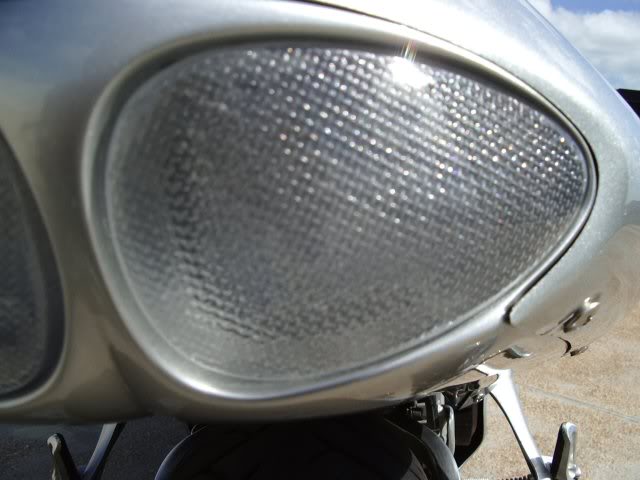

Here's my modified UFO that I modified before I ever put on the bike!
 My modded one is the absolute brightest tailight ever on a 'busa!  122 red 20000mcd LEDs, 61 per lense.  Not only does it look completely empty when off, but no tiny circles either when on!
 Pictures don't do the LED justice, if looking directly at them, you still see 122 dots for the following 5 minutes!
