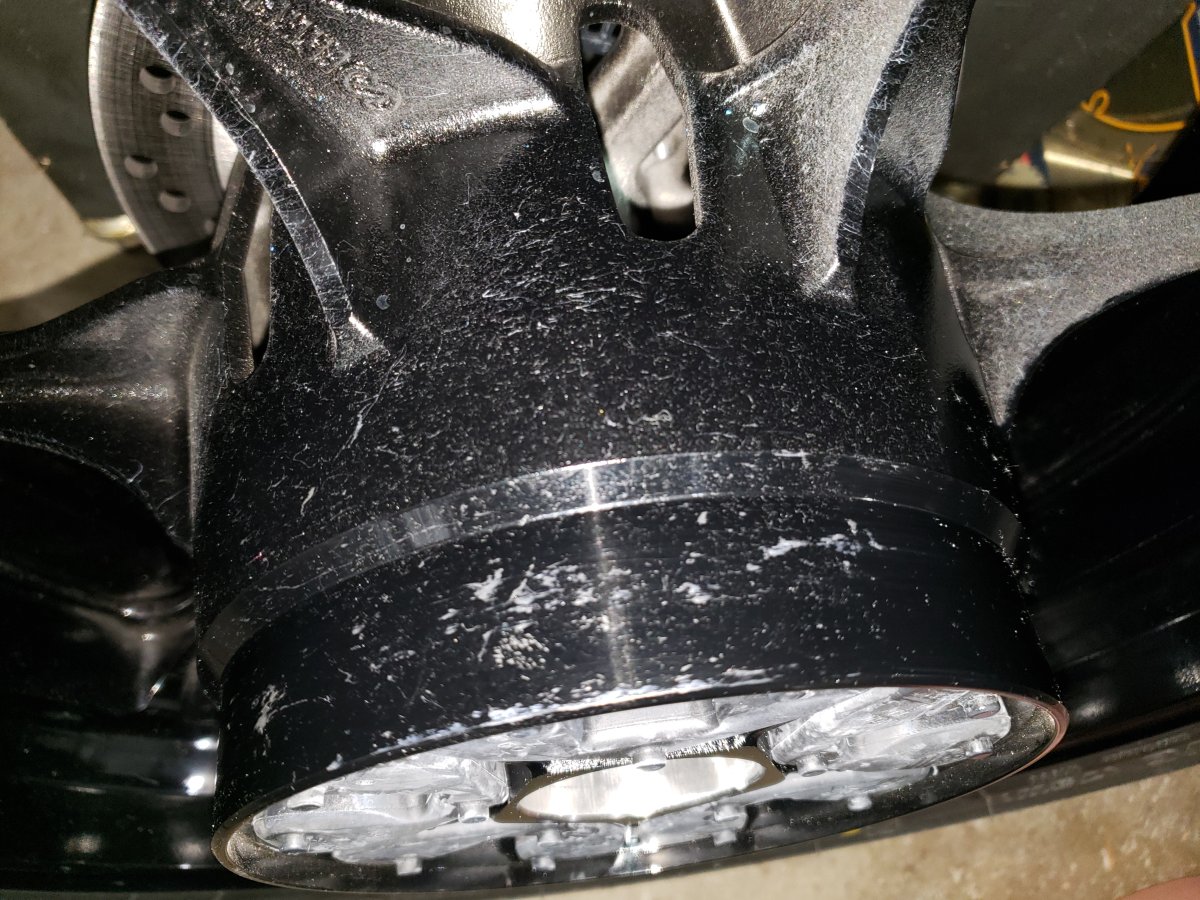

Forgot one. The wheels are a pita to clean and have a lot of sharp edges. They seem to somehow collect and deposit more dirt on the rims compared to previous versions. Cleaning the rims on a gen1 or 2 is a lot easier and almost therapeutic.

Especially when the god awful chain lube they put on flings all over it as well. Tackiest nasty garbage that I stopped using back in 2007.
That stuff is nasty, I used mineral spirits to get it off, I lube with chain wax and when I wax I let it dry overnight does not fling.
I ended up using WD40 and paper towels to get the majority off, then I used a microfiber cloth and some dish soap to finish up. As for the chain soaking it in Kerosene didn't do much though. Only got it off by using a coarse plastic brush. Have no idea if it is Cosmoline though???? I also prefer wax chain lube.
I haven’t cleaned the chain on my gen 3 yet but on my ZX11’s the best cleaner I used was WD40. Center stand, idle in gear, soak with WD40, let sit, spray rinse with water hose, spin dry, wax, let wax dry overnight and good to go. May not be everybody’s fav but worked well for me.
