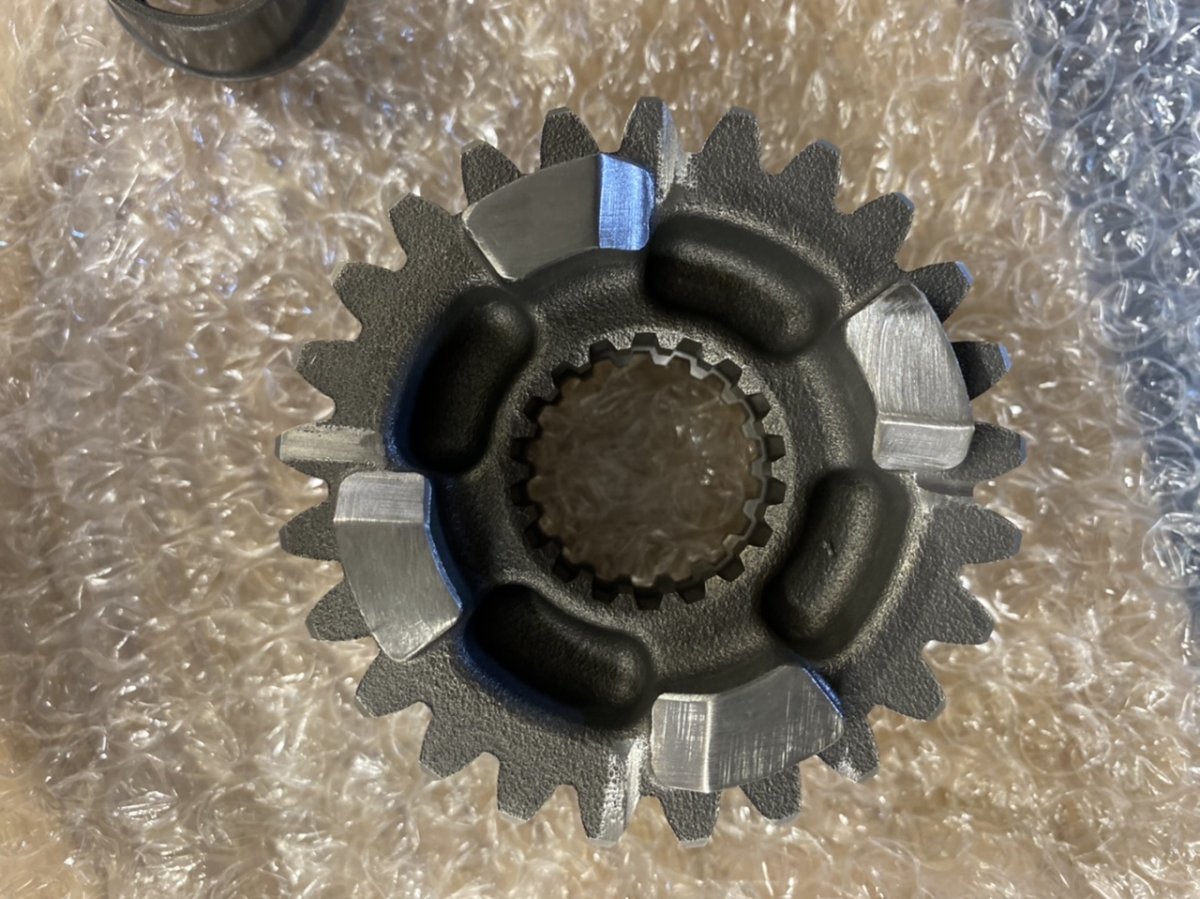

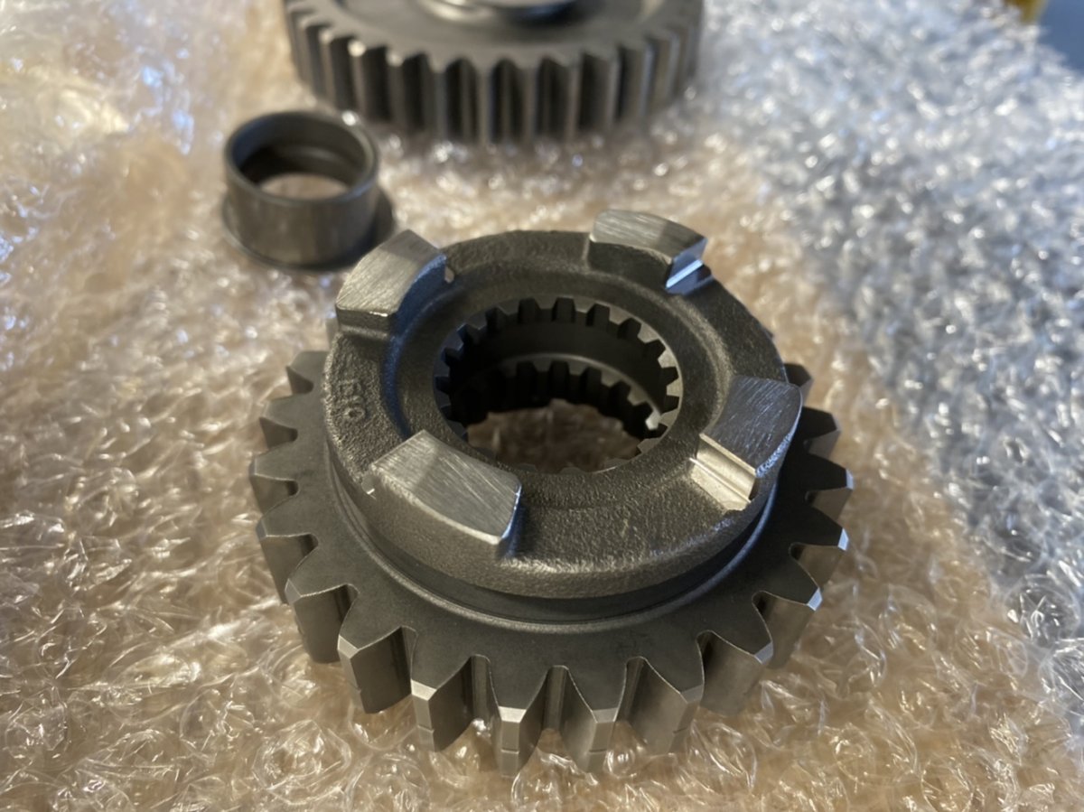

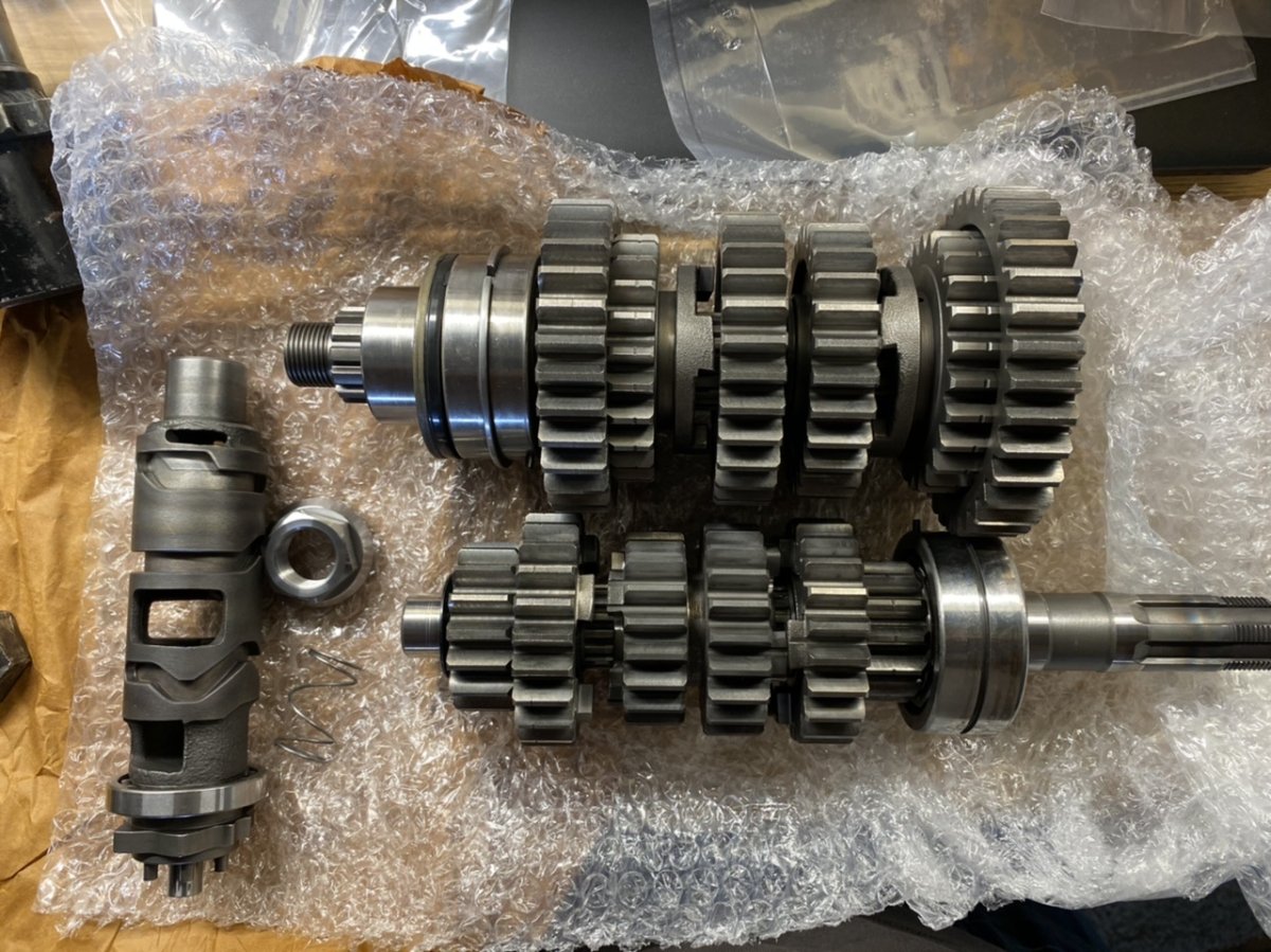

No trans
I’m not gonna put it together and then split the cases again just to put the trans in it. Found a better lead time than 12 weeks-supposedly. We’ll see.

I’ll eventually get my back up crank balanced and the gear removed but the one I’m using was freshly balanced and lightened when I bought it so I’m going with that. Transmission will be here monday

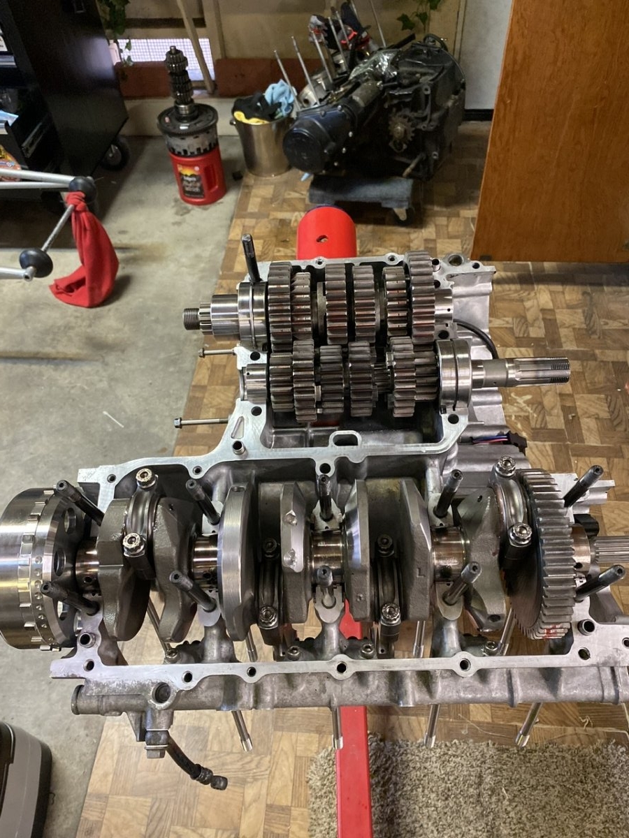

Trans is done!
Found those pesky dowel pins, went together pretty quick. Something nobody mentions besides having torque wrenches and the right size sockets (12 point for arp fasteners), a tap or thread chaser and a stainless wire brush will make your life easier. Brush off all the bolts, and chase alllllll the bolt holes and blow em out. 10mm x 1.25, 8x1.25, 6x1.0, covers everything that holds the cases together and the exhaust holes. Cheap amazon ones are fine, u just cleaning them out. Anyway here’s some pics
