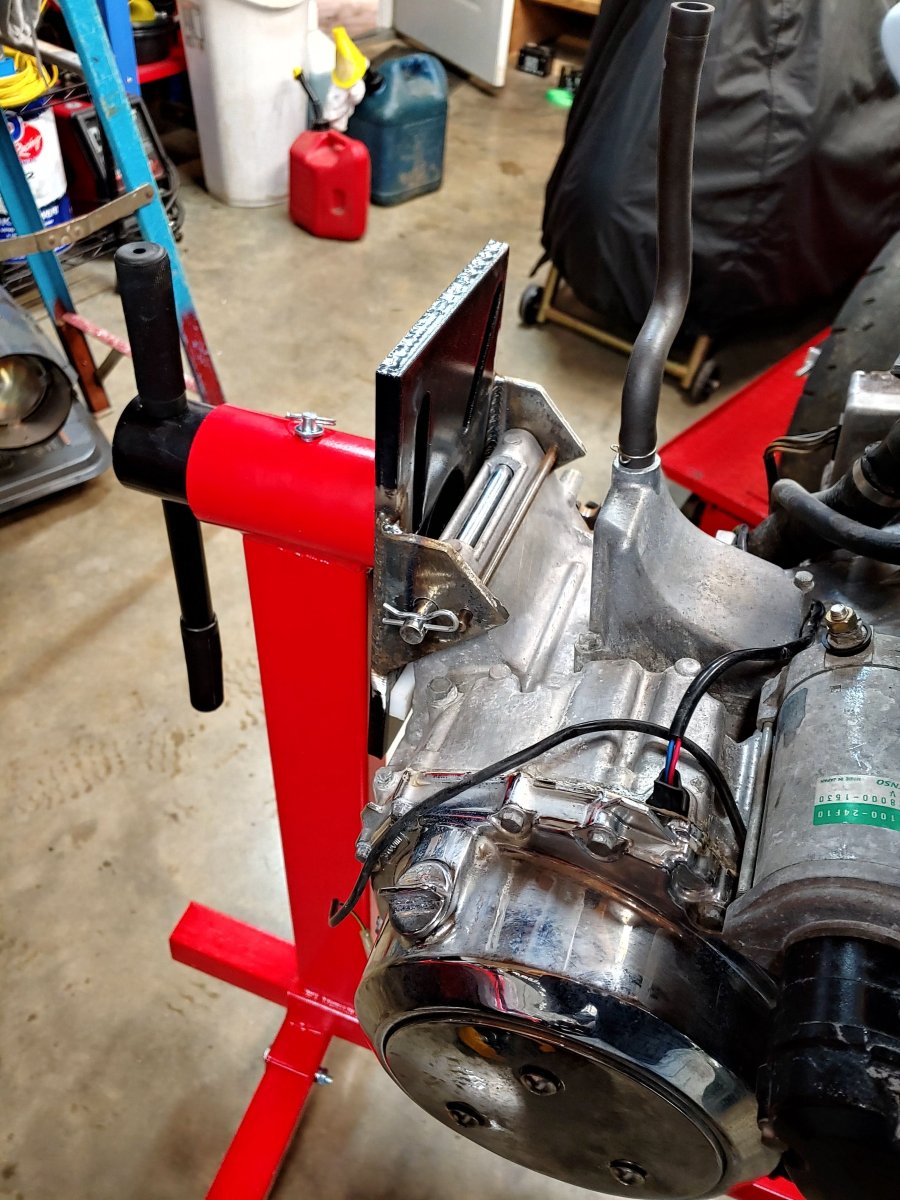

I was going to buy dogwood bracket. Then I got an idea. And those seem a little pricey. I would like that oil pan though. I posted a thread on that a few years back. It's spray painted and works great. You see I used a broke 3/8 extension for the pin? It's not easy living this cheesy.

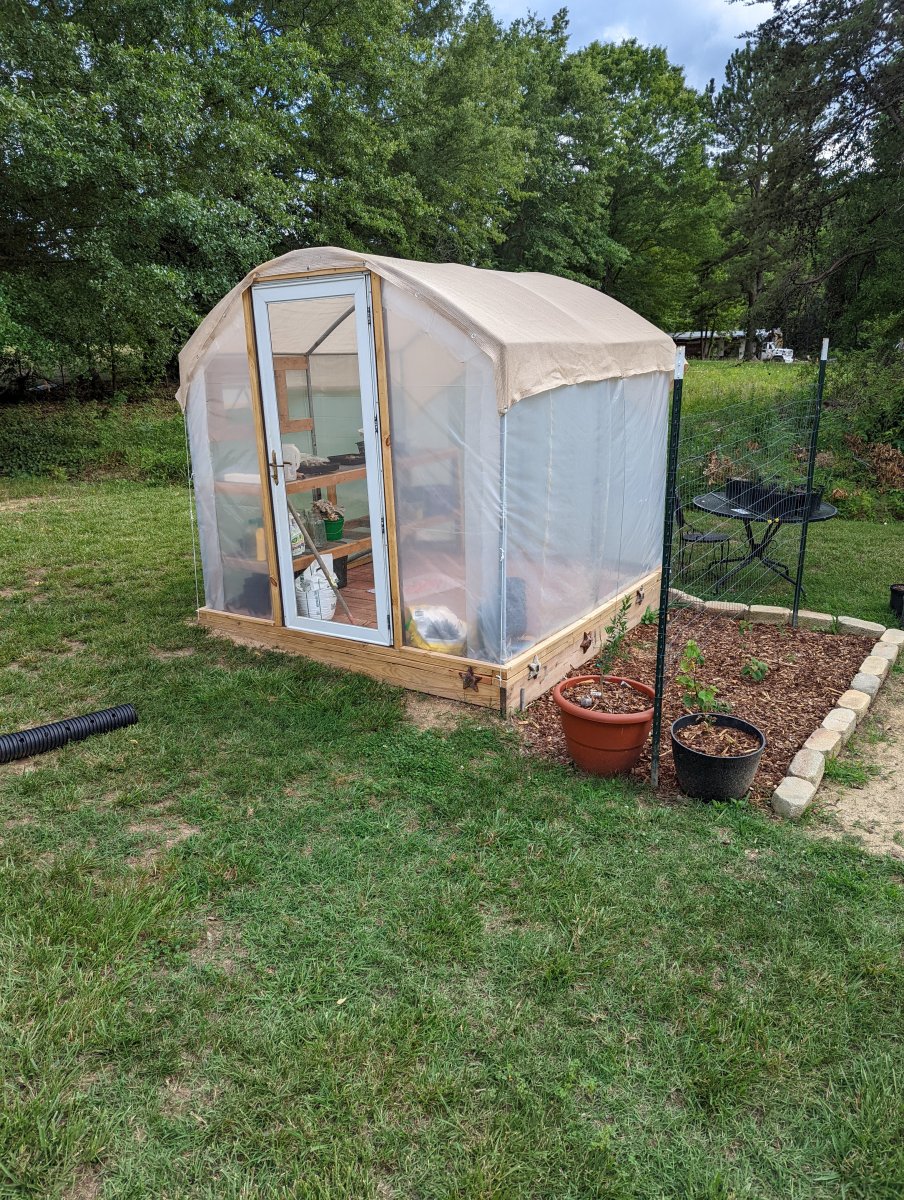

Used baby's trampoline I took down to build wife's greenhouse month ago (8x8). Saved a lot of money, but the time it took me I could have worked and bought a nice one. Its tougher than those cheap ones, I'm bad about overkill though, I didn't need to weld both sides of that bracket for engine stand either. If this pertains to turbo build.
