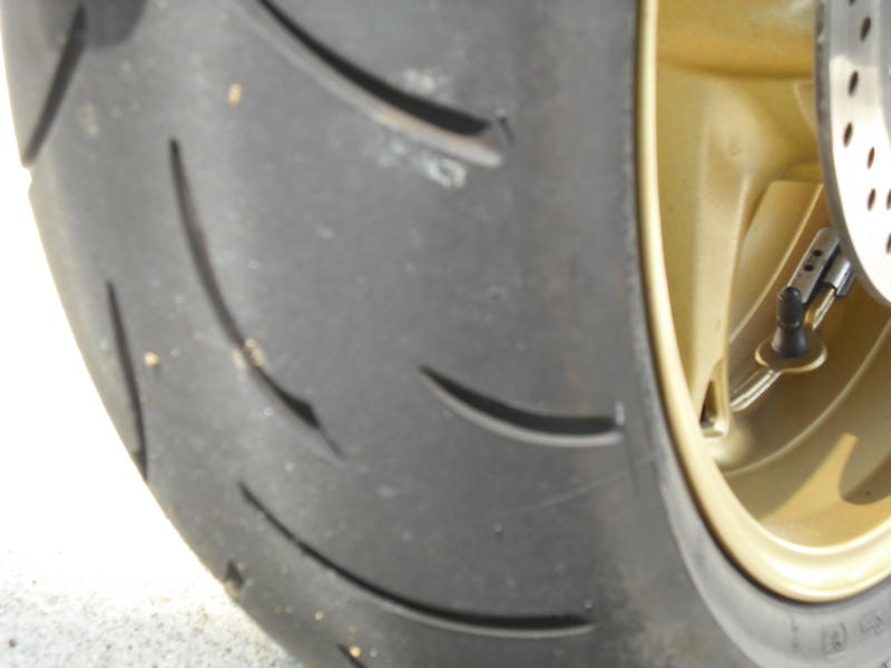

OK...Got my chain all tightened up and everything feels MUCH better. I haven't had a camera handy therefore no pic of the rear rubber. I'm on the way to my buddies as soon as I finish posting this and will take some pics with his camera.

sorry it took so long but here's the pictures of the back tire as requested. I didn't want to admit it but I had the dealership adjust it when I had it in for the 4000 mile service because I didn't want to adjust it wrong.

plenty of good rubber. as i was reading this post, it sounded like the chain tensioners backed out and caused the wheel to slant.
it would appear to me that that back tire has little or no cornering time on it.. (note the unused areas).. it is possible that what you felt could have just been the tire trying to "scuff" in a bit or you just do not have a feel of what a bike tipped over a bit should feel like.. (this is a problem with starting out on a big bore bike IMO)
From what I see, there is no way the back of the bike is sliding at all.. (and not much evidence of any "power sliding" either..

Tire looks in good shape and your not getting at any extreme angles based on wear.
If tire pressure is enough to keep the sidewalls from squirming I would say its a road surface issue or a throttle control issue. With over 100# of torque delivering to the back tire too much throttle can make the tire step out. A rear slide of 2-3 inches feels like a lot more when your leaned over. But based on your tire wear your not that ham fisted. My stock 15 was shot at 3500 miles. Be careful and hope you have some good gear.
Maybe check your wheel alignment. If the nut was loose enough to make your chain loose your wheel could not be running straight. The chain could have just stretched though.
