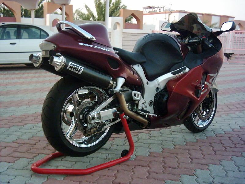

ok, I had narrowed exhaust choices down to Akrapovic race system or the HMF dual high mounts. I've decided to go with the HMF system and was curious for those that have recently installed this system if there are any fitting or clearance issues that I need to be concerned with.

I have the Akra Evo system. It is by far the best made titanium pipe I have ever seen. The welds, fit, finish and attention to detail are incredible. It fit PERFECTLY too.
Now for an actual answer to your question.
The HMF's ARE a bit of a b!tch to install. Fortunately there are some really good walkthroughs floating around out there complete with pics. They don't have a lot of clearance so take your time and get them lined up nice and tight with the bottom of the bike. Make sure you leave things loose until you get all the pieces in place and have test fitted the fairings.
Also, with the tight clearance you will run into heat issues where the pipes come close to the fairings. They don't send you anywhere close to enough heat tape to cover all the close spots on the fairings. There are 2 solutions for this.
1. Wrap the headers with exhaust wrap all the way to the x pipe.
2. Get some heat tape from a hardware store and put it on the fairings.
I went with #2, I think NitrousJunkie went with #1. Either one works, just make sure you take your time and check for hot spots.

What they both said. This system takes a bit of tweeking but the results are unmatched. The highest Hp increase (with a PCIIIUSB) and the best looks and sound. IMHO. I have about 4000 miles on mine so far and they are sounding better all the time. Just keep getting a deeper tone and a little louder.

I saw a post on this site where 4 friends all went to the same dyno on the same day and had their bikes done. If I'm not mistaken, they were all comparibly modded and the Dual HMF Hi Rise system came out with the most HP. I found that B4 I bought mine which was one of the reasons I went with the HMF. That and they just look awesome!
To answer the question... follow the directions and take your time. These systems are made with very little clearance but they WILL FIT if you don't rush the process. Go ahead and bring in the block off plates since her front's gonna be exposed.
