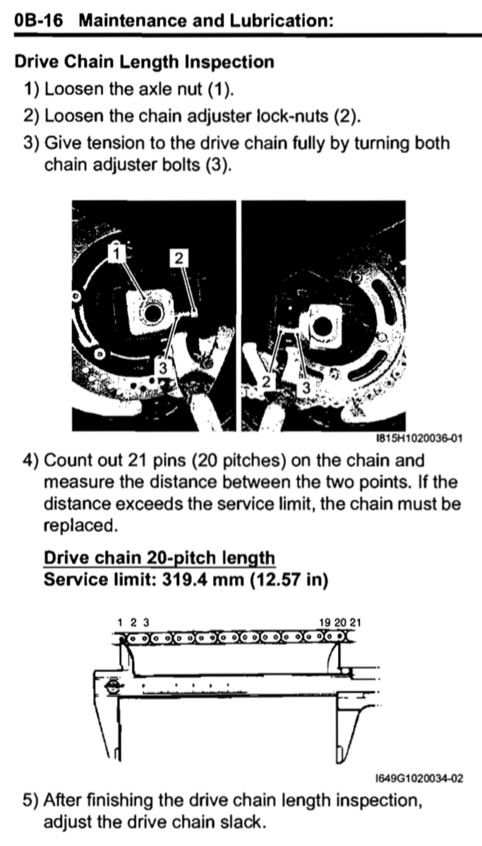

What is "...took the time to measure the 21 pins"?
You measure the length of 20 links on the chain to determine how much the chain has stretched. Twenty links is center of pin 1 to center of pin 21. There is a specced length that 20 links should not exceed and if it does, it's time to change the chain.
The procedure is described accurately and the diagram is drawn correctly but the labeling is misleading. Looks like the calipers are measuring 20 pins according to the label but if you count, it's 21. Anyway, if you measure only 20 pins you will see right away that it can't be right. Measure 21 pins center to center, do this at a few different places around the chain just to be thorough.

319.4 MM. OK. I have never done this measurement in 40+ years of riding.
0ops.:D I just grab the chain at the half way point between the 2 runs at the back of the rear sprocket and attempt to pull it off the sprocket.If it pulls away a bit,I call it OK. If it pulls away a lot,I get a new chain.:thumbsup:
I am going to start measuring from now on thou...you've caused me great paranoia Mythos.:shocked:
