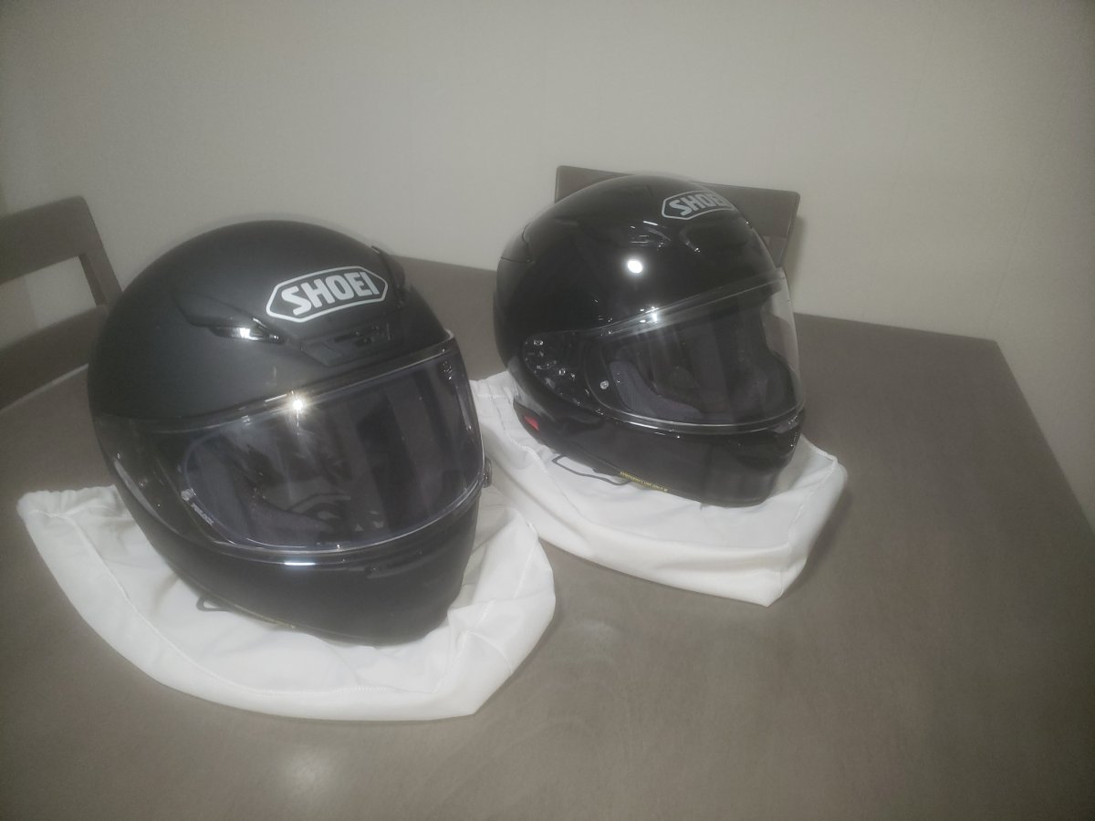

The local Suzuki dealer(under new owners/management) gave me a deal on an RF1400 yesterday(new gf loves to ride, it's hers).
Cheapest I found it was $529+ tax and shipping online...she paid $473 after tax.
These guys have my business.
Next to my matte black RF1200(about 2 yrs old).
I asked about a photocramatic/transitions shield for the 1400(I have one on my 1200 and it's excellent), they said the North American Shoei distributor is still out of stock until who knows when, but $209 when they could get one(my 1200 shield cost the same).
The 1200 has the shield opening tab on the left, vs the 1400 with it centered with a push button release/lock, and the 1200's upper rear vent can be closed, the shape of the shell is different too, but the overall differences in the 2 are minor.
The 1400 was in stock, the gloss black she Wanted, and a great price...so the 1400 it is! lol
As for your Busa, much respect for a great job, especially having never done it before.
I know it feels good riding it, and a little better knowing just what you have, and how you got it.

I somehow missed your message, but good info on the helmets. I actually just received a RF1400 today with the faust paint but it is too small and has to go back. My RF1000 is a large and it while it fit okay, I thought maybe a medium would fit better and move around less but it hurts to put it on because the shell is too small. I picked it up for $530 on sale and now can't find any on sale anymore of course. So I ended up paying full price for a large. I can't deal with the 1000 not having any padding on the top anymore, it's just not safe.
