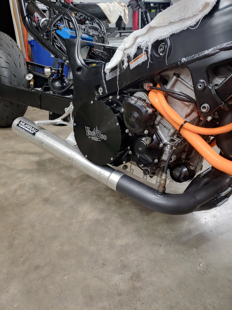

Got the autoshift and wego 3 straight. With a few hickups its done. Now to the nitrous
Pushing on. Move the fuel cell. Bracket, clean and change jets on solenoid. Got this filter that is in the fitting. And a black line. Now the bottle bracket-bracket. The holder is at a 45 for a big bottle but I use the 2.5. I have 2. Put the air gauge on a 45 to see better and a mini connector for the full. I am still working on co2. Will be this winter. But I got to get this this out to run.

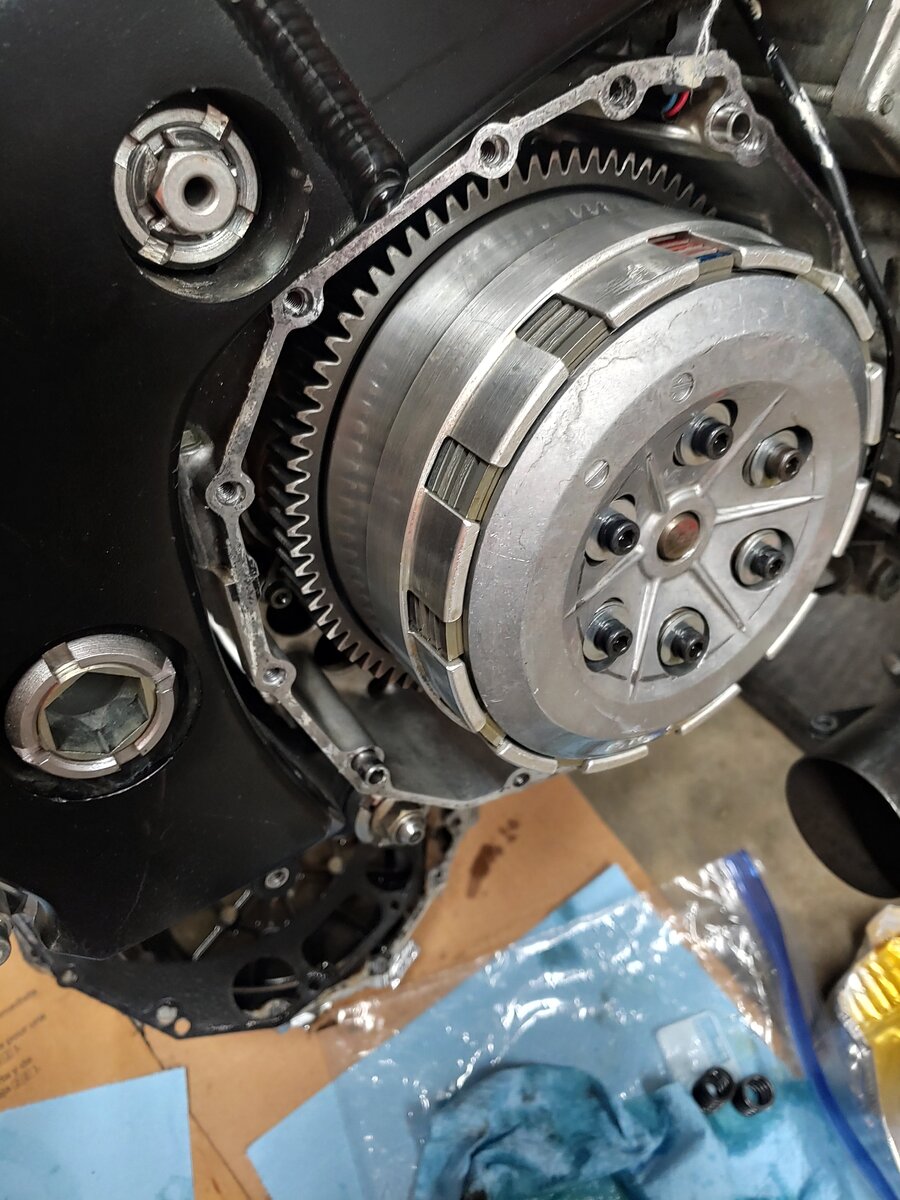

New clutch plates. I ran on a deal about 2 years ago for a billet outer and inner. Couldnt get the inner to work on the other bike. The clutch would slip when I used nitrous. The springs didnt work well, and I was using the kit from mtc . we will know soon if this combination works. I have a single stage lock up I bought used about 3 years ago I might install next if I have problems. And the new clutch cover. I worked for 2 days to pay for that and a lot of sacrificing in other ways. Very humbling feeling to stand back and look at all if this.
