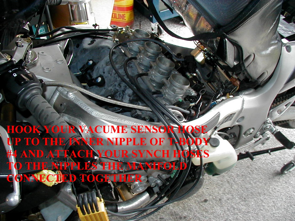

I have a question, how did you get your bike to start without the IAP air press sensor hooked up? I can never get mine to start without it hooked up.
I'm not sure which one of the two sensors that is, but I had to unhook both of mine to get the bike to keep running. When I had the sensor on the back hooked up, and the lines to the carbs unhooked (so that I could hook up the carb stix) the bike flooded like crazy. When I unhooked the plug from the sensor the bike ran fine.
you hook the iap sensor to the inboard nipple of the #4 throttle body....the same nipple where you disconnect the small vacume hose that goes to your "P.A.I.R."...and use that one for your iap sensor hose...like so....
I removed my P.A.I.R. system so that one gets a 5/32ths vacume cap now.
EDIT/PS: You'll also want to actuate your "Fast Idle/Choke" lever to keep'er running to hold an idle with the airbox off like that.
Hope that helps and....L8R, Bill.
