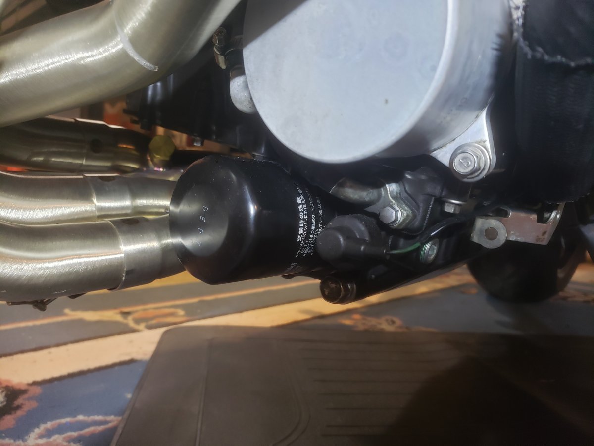

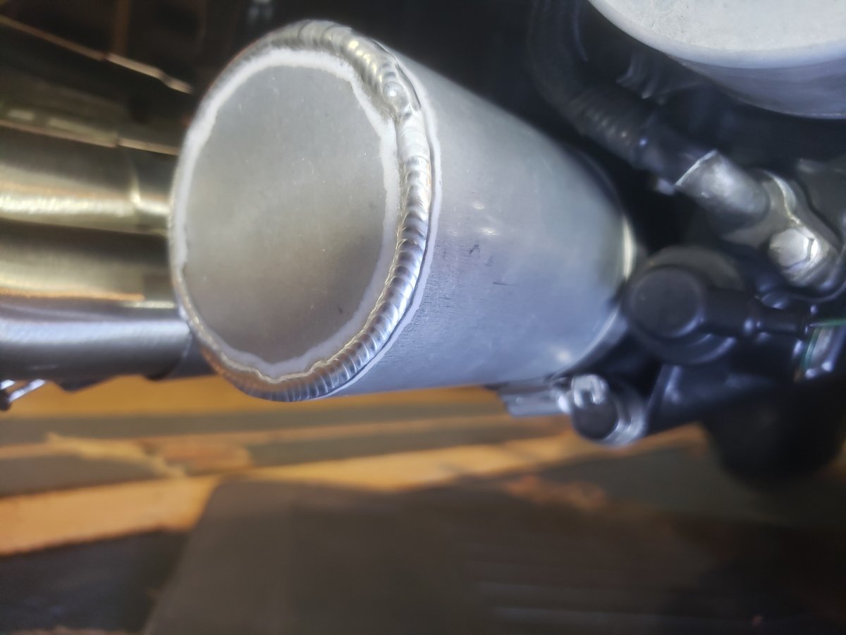

Oil filter guard.
Just an aluminum sleeve/cup with a hose clamp, but could save the day.
The oil drain plug and oil filter are very easy to get too, even with the fairings on, but the filter is low and at the front, so it's unlikely, but possible, for a rock or road debris to puncture the oil filter.
Cheap and easy, and the previous owner already put a radiator guard on it as well.
Oil filter guard.
That's where the oil filter is on most (older) Suzuki engines, right in the middle front.....interesting filter guard....

Oil filter guard.
One of the first mods I did on mine! :thumbsup:

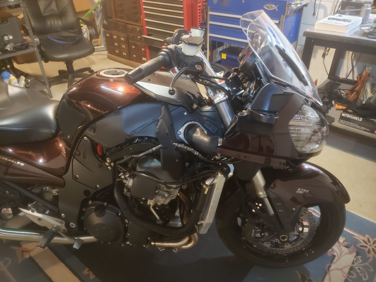

Man, that windscreen (was) huge. Do you have a buyer for that equally huge (and ugly) top box? :)
Yes, the windshield was big, but I like it now. It looks better than I thought it would.
It is also in it's lowest position, and will go up another 4"-6"
I don't like the looks of the top box either.
But, my girlfriend likes the backrest, the storage is useful...and a backrest to replace it with is about $200...so the box will do for now, lol.
