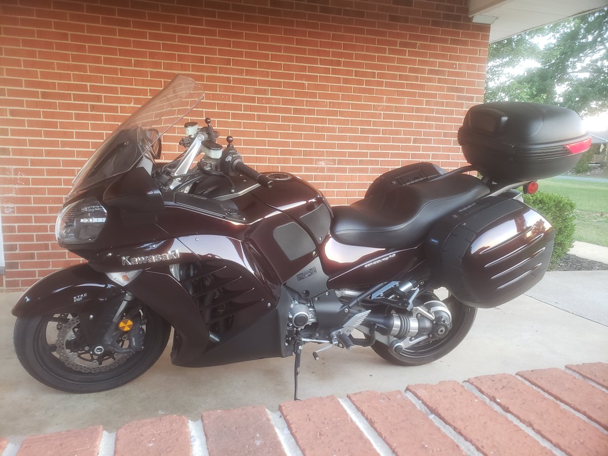

I traded one dinosaur for another, my 2020 Yamaha Raptor 700se 4wheeler/atv...for a 2012 Kawasaki Concours.
I had nowhere good left to ride the 4whlr, and wanted to sell or trade for a good sport tourer.
The Gsxr1k isn't going anywhere, the 4whlr was paid for, and I was looking for a good Budget long distance and 2up ride, that was not a cruiser.
Yes, there are better sport touring bikes out there I'm sure, but for the money, nah, this thing is pretty good.
Trade in on my Raptor was $7140
Dealer wanted $8399 for the Concours.
We did a straight up trade.
They put a temporary tag on it too(traded in NC but live in VA), but went to the Va Dmv yesterday too.
Tag and title fee $350, plus $40 in tax.
Plus, liability insurance is $124 a year, lol, Thank You God.
So I'm $500 and a 400 mile round trip into this thing, no complaints.
It has 14k miles, new tires, oil change and brake/clutch fluid, a clean title, aftermarket seat(very comfortable), a radiator guard, grip pads on the gas tank, battery tender pigtail, aftermarket top case, a Ram Mount(taking off and buying a QuadLock), drop pegs that I already drug the road with, but fortunately found the stock pegs in one of the side cases, along with another key and a cover.
The exhaust is stock...so I already ordered a full BlackWidow, lol.
I'm going to get a reuseable air filter, a Shoodaben ecu flash, am going to email Core-Moto and Spiegler about ss lines, and hopefully upgrade the front pads.
I have only rode it a few miles, and made no suspension adjustments yet, but I am really impressed with the handling and stock power...all things considered.
I was told it was black, as it looked in the pictures the dealer sent, and they had another used black Concours there...however, this one turns reddish green in the sun, and is a black/burgundy color otherwise.
Oh well, I don't care, it looks black or dark enough when I'm riding it, lol.
