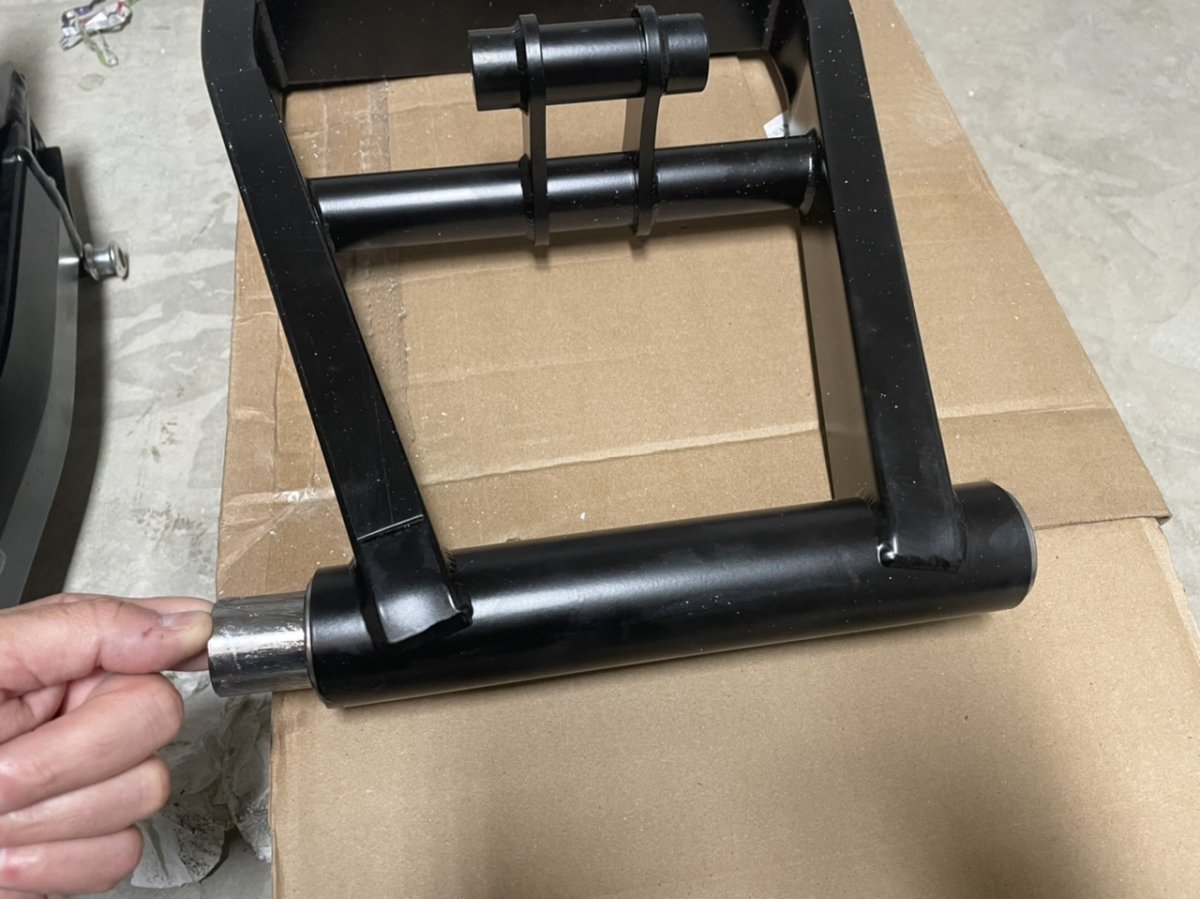

I bought an Evil 4-8” over and paid for them to press new bearings in. Had to send it back because the bushing wouldn’t fit inside the bearings. They kinda fixed one side but the other still wouldn’t fit so I just returned it and got my money back. Brenda at Evil was great to work with and she said they don’t really press the bearings in. She said they didn’t grind enough and the bearings were being squeezed in. All good and I appreciated her customer service.
My friend got an evil arm 0-4” on his zx10 and the pivot bearings didn’t spin at all. Evil said it was supposed to be like that.

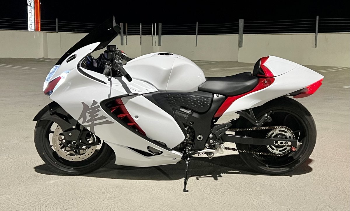

I’m in an evil 0-4, I’ve gone back one more holy in the axle block since this picture. I’m debating on getting a 3-7/4-8 and going 5” back or so. 1st gear the nose still gets a little lighter than I’d like it too and it seems like some of the “fast fast” guys started 0-4 and are on 2-6 or more now that these bikes are getting figure out a bit more.
