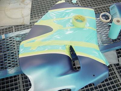

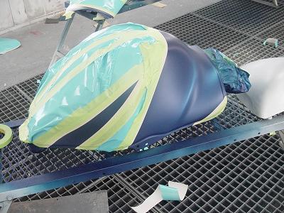

Now we have to mask out for the white graphics, with the way we sanded it, we could luckly see the factorys lines to go off of. Instead of having to make our own lines. They showed through the blue just enough to be able to tape right on them. This is the not-so fun part.
here is us trying to get that fine line tape just perfect over the factory lines. We wouldnt want there to be 2 different lines NOW WOULD WE?
