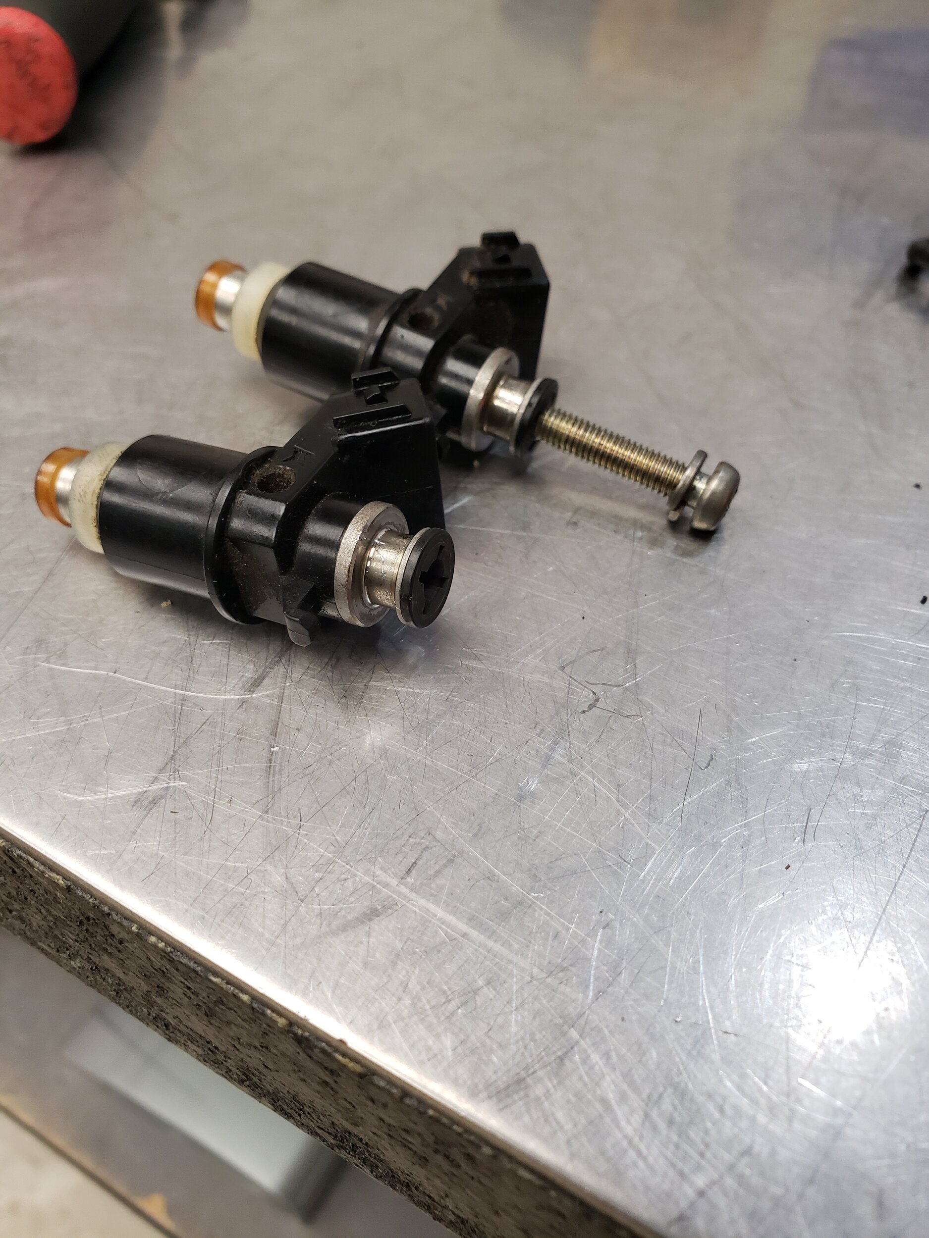

On another note, thanks for the awesome tips on injectors. Does anyone have a pic of the filter coming out of one of these buggers?

As for the injector filters, they are aftermarket only, as Suzuki considers them part of the injector.
To replace them, you need to thread in a machine screw of similiar size(I forget what size works(M3 or M4).
The threads just chew into the oem filter itself, to grip it to pull it out, and a vice can really help, as some filters can be difficult to pull out.
Once out, I then flush the injectors both directions(spray cleaner), and activate them with a battery when doing so.
Then, put the new filter on a flat surface and Gently push the injector down on it.
I have also yet to find any generic o-rings to fit any injectors, as most are odd or part specific sizes...hence your previous leak when you tried them.
These are pictures of the last injector filters/screens that I replaced, and are from my Gsxr1000.
The injector filters usually disintegrate before they clog too
These injectors look different from the Busa's, but the assembly and function are the same, the parts just are not interchangable between the two.
