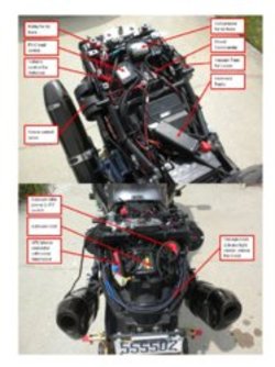

image.jpeg image.jpeg Yay, got my Rostra couple days ago. As I was trying to fit it in the turning signal cowl it was clear it would not fit. Will have to do the trunk mod first.
Finally fitted in to the trunk! Does anyone have recommendations for the dip switch settings on the electric version? Mine is now as twotonevert's 000011100100 where 1=on and 0=off.

I tested my cruise earlier and yes it works better than I thought. Maybe the slack adjustment will help more, though I don't have very much slack even now. The cable can't stuck anywhere as I routed it through electric pipe (see pic).
