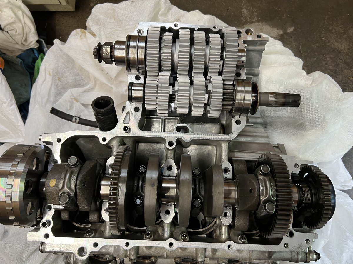

Finally got my package from Schnitz, put in the new large fork and buttoned up the water pump and gear selector housing. I keep going out in the garage trying to find something else to work on, but nothing left to do until the trans comes back.

first time digging into a motorcycle transmission ?
man don´t start that
either you find a neighbor with lots of exp. to learn you by showing you each single step
or you join a suzuki shop
it is a damm hard job to get motor out and open and closed and in again
and in my view impossible for a newbie.

Thanks for the suggestion, but if you look through the thread I have the engine out, split and trans is sent off to get undercut. I may have no idea what I was doing when I started but I've learned a lot and I'm a pretty smart guy.
Work comes early in the morning so I'm done for the night, but made some good progress tonight. Only had a couple hours to wrench on it but the engine is mostly assembled and so far going nice and smooth! Just following the service manual and reading everything multiple times before I move on to the next step. Fingers crossed it continues to go nice and smooth.
I work from home most days so I'm hoping to be able to spend a few more hours in the garage tomorrow. Should be able to get the engine fully assembled tomorrow then the not so fun part of getting it back into the bike.
Without the extensive knowledge you all have posted over the years there is no way I would of had the confidence to tackle this myself so thanks to all of you!
