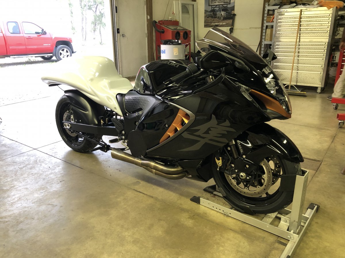

Pingel told me they had to machine open the clevis to fit the gen3 shifterView attachment 1637034It will be a couple weeks before his exhaust arrives. We have the oil pan ready to go on. It needs a larger than standard clevis for the air shifter.

Let's see how far this machine will go....
