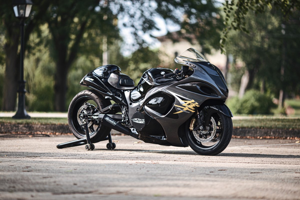

Decided to go and crop this photo. Looks a little nicer like this.

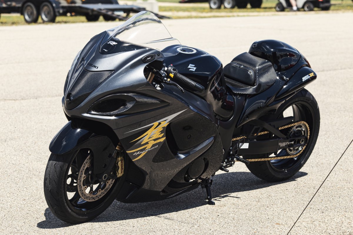

My bike is all torn apart waiting for a few things. I thought while it was apart I would do some simple mods that hadnt been done officially yet. Had the pair caps capped off, but I went ahead and put the Brock's plates on now instead. I cut out the ABS a few nights ago, and will hopefully be getting around to installing the new Galfer lines this afternoon. Going to do some cleaning inside as well.
Montgomery CF bars, and fitted some quick releases on the tail. I keep breaking aluminum bolts in my DME subframe and I'm sick of it, so everything is going to QR now. Galfer lines are installed up front, but haven't been bled yet. Waiting on a custom rear line from those guys currently.
I also just gave all the stuff inside a wipe down for the first time since I've owned the bike. It was looking pretty dusty.
Waiting on a tank, and still have to install my DME clutch cover.
I think I'm going to head out to Indiana in August for the Airstrip Attack event. I'm really curious what I could go in a half mile with the current setup.
Finally this thing is back together. I had a CF tank on order and after 8 weeks the company still had not started it so I just told them to give me my money back. Montgomery was backordered on the quick release buttons but they finally came in last week and I got everything done this morning.
Finally this thing is back together. I had a CF tank on order and after 8 weeks the company still had not started it so I just told them to give me my money back. Montgomery was backordered on the quick release buttons but they finally came in last week and I got everything done this morning. View attachment 1639208 View attachment 1639209
Basically done with this thing for a while. Just going to ride and race it. Back to work on the 750. After that I'll be back on to the GS1000. I've been way too busy and have spread myself too thin across my projects.
