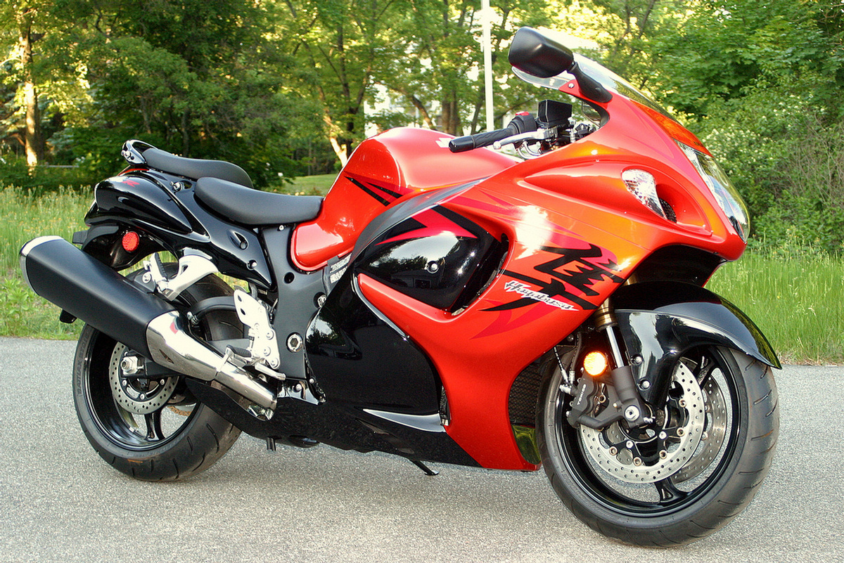

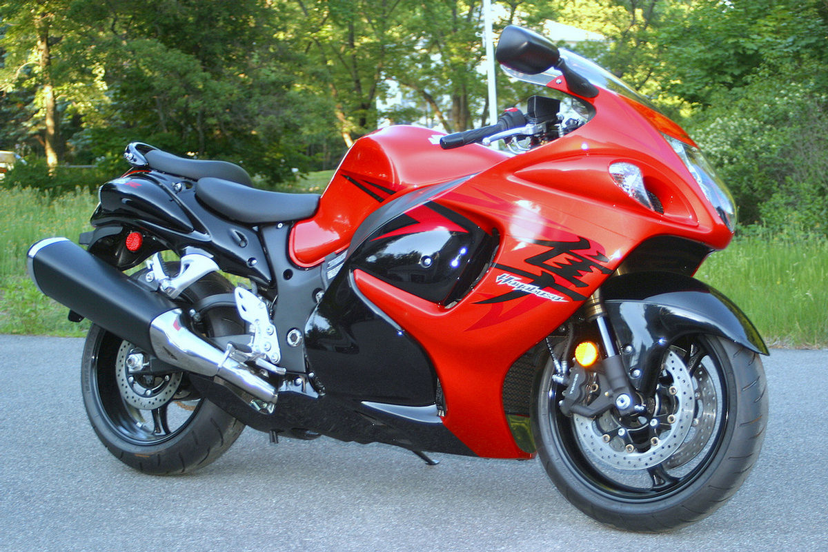

Nothing but good luck yesterday. Picked up the bike and all I can say is AWESOME!!! Thanks to everyone for providing such good detail regarding the recall. Now for the fun, see below...
Ejoy,
David
