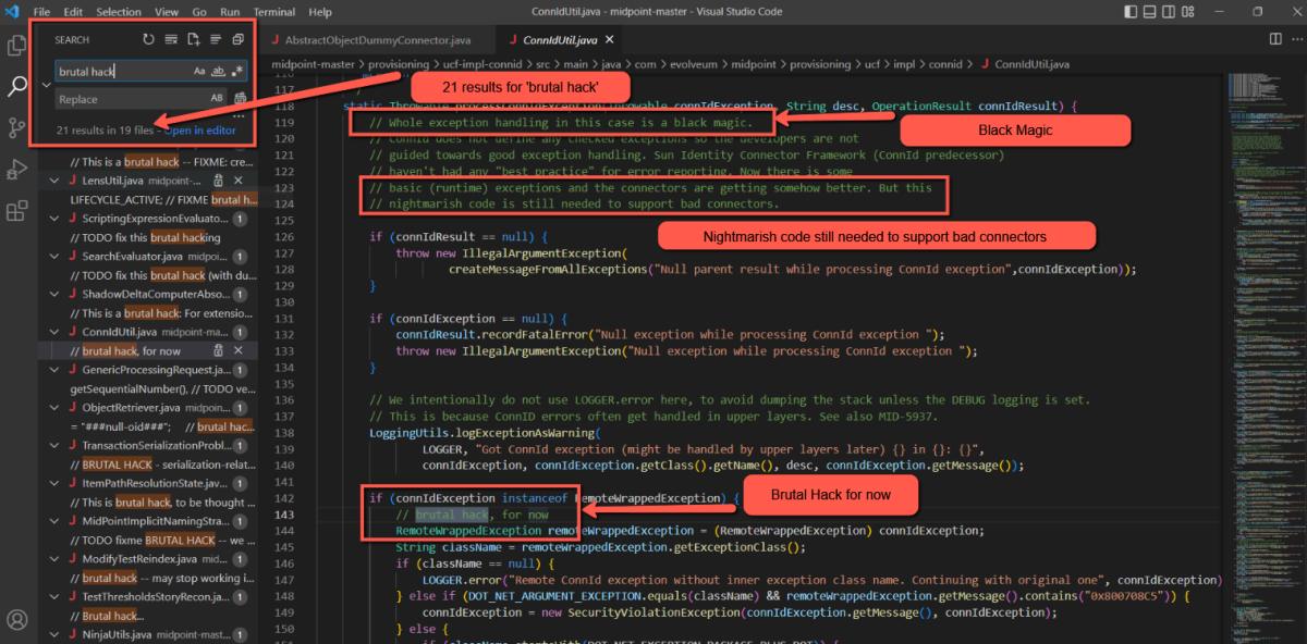

Here is the source code of an open source product I worked on at my last job. 21 results for 'brutal hack' and over 900 for just hack. This is actually cleaned up since I saw it a year ago. Anyone can download this on GitHub.
