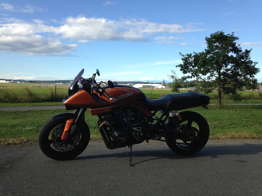

Further inspection revealed that I was to blame..... last fall I did a starter clutch in the bike after it decided to shear the bolts holding it to the flywheel. Seems that when I was putting it all back together, I neglected to seal the wiring exiting the inside of the case to the starter motor housing. Oil was splashing off of the starter gears, through the gaping hole, down the starter housing and out of the drain hole at the bottom. D'oh!
1621403
Guess I got so focussed on sealing the outer cover that the inner seal was missed. *sigh*
Luckily I had a perfect sized grommet in my stash and a bit of silicon later has it resealed. I hope. My next ride will tell the tale.
The lesson learned? Don't be an idiot. :banghead:

Ironically, I ran the bike in the driveway twice after the fact, plus I rode it up and down my road once. I think it was finally reaching higher rpms that caused the oil to fling out.
In the end, only 600mLs of oil departed but yeah, the rear tire.:shocked: Luckily I spotted the leak fairly quickly and immediately thought of the tire... I rode like a nOoB rider straight home, keeping the bike as near to upright as was possible.
I'd have cried all night if the Kat had gone down.... she's just so pretty!
