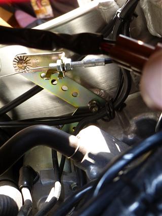

How much slack do you have in the cable leading to the throttle?
No, I don't have your notes, but would be happy to get them.
There's about 1/2" of slack in the cable, loose, but not flapping in the wind.
There's room to adjust it if needed. Should it be looser?
