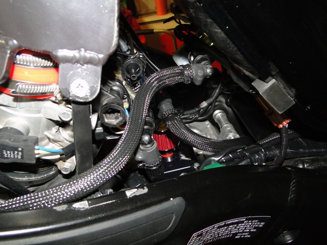

I installed this little union in the boost line as per the GlowShift instructions.
It looks like it's to keep water or condensation out of the signal box.
Could this be contributing? I may try to pull it out, install a straight connector, and see what I get.

I wouldn't think that would affect it. Another reason it could be reading lower is if you live at elivation. I'm still willing to bet it's just off.
Nope, at sea level, so that can't be it.
I do have an auto meter mechanical that I can throw on there if nothin else works.
I'm gonna go over the lines tomorrow and see what I can come up with. Thanks for your help Murdered.
