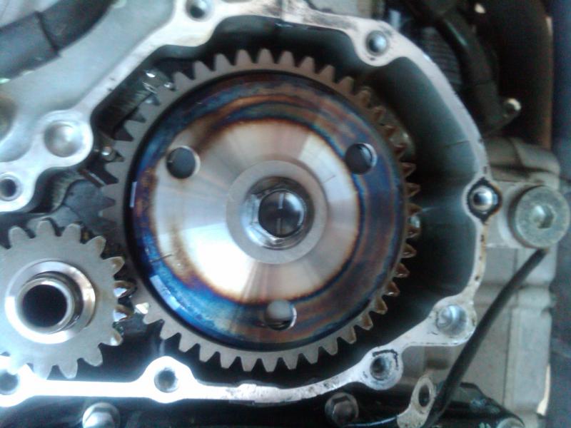

here is a pic of the unevenly overheated starter clutch
Ouch! Is possible to tell why it overheated so much? Improper install?
Its factory installed part. I hope not. They all will look a little heated. It evidently overheated bad when the previous owner attempted to start it too much with a dead battery.
The thing of concern with this picture is the uneven heating.
This is whats causing my hard starting when its hot. Its seizing up on the bearings as a result.
The little springs and clutches are unevenly applied i guess
